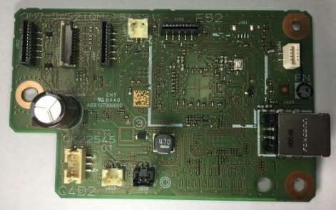

Canon G1411
Main Board QM7-5452 (QM4-5433) / QK22545 01

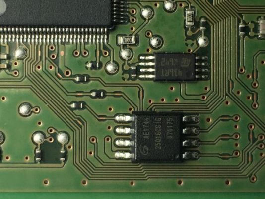

416RT(24C16)
25Q16
