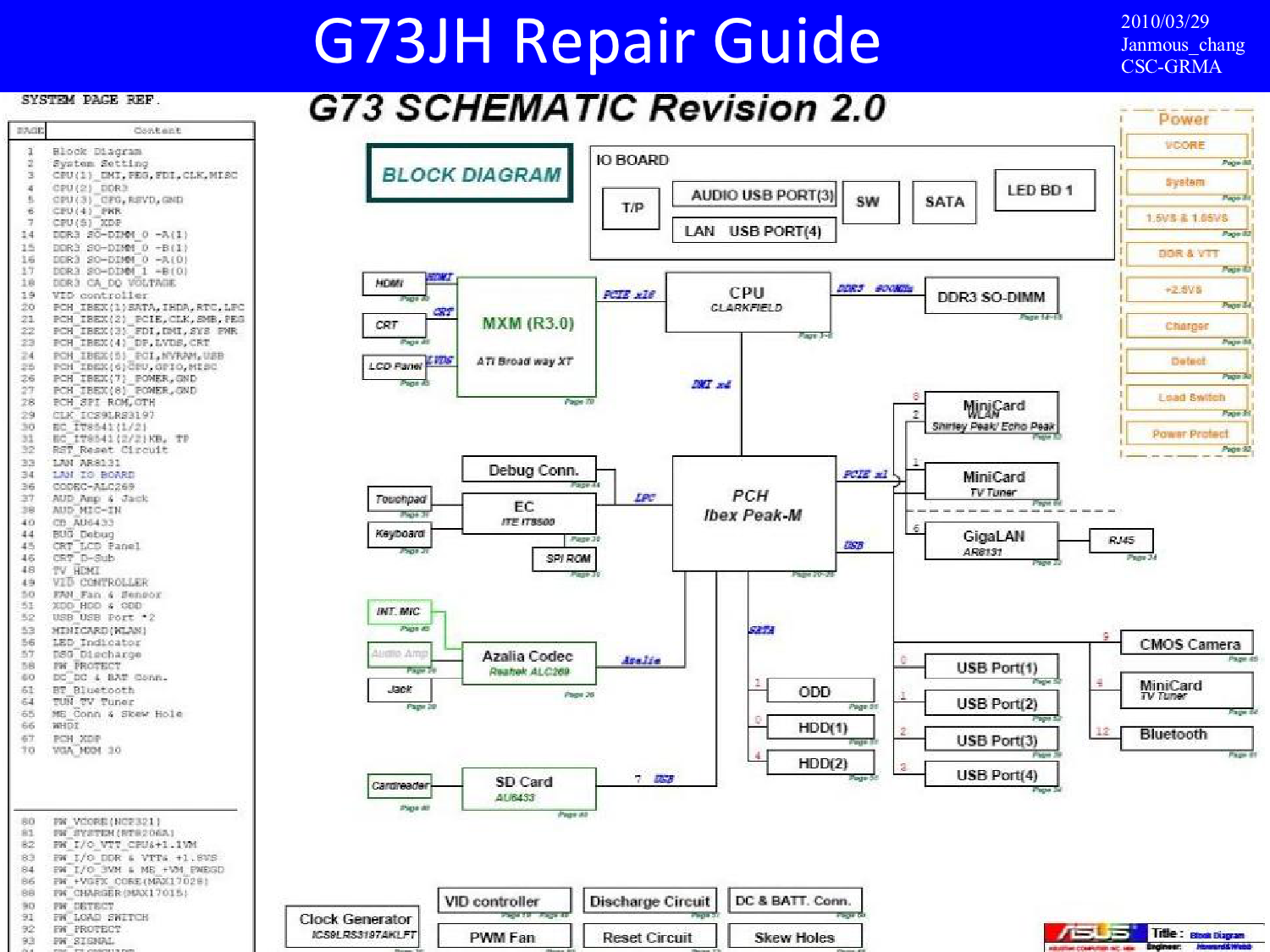

Repair Guide Asus G73JH G73 Rev:2.0 2017-04-22
