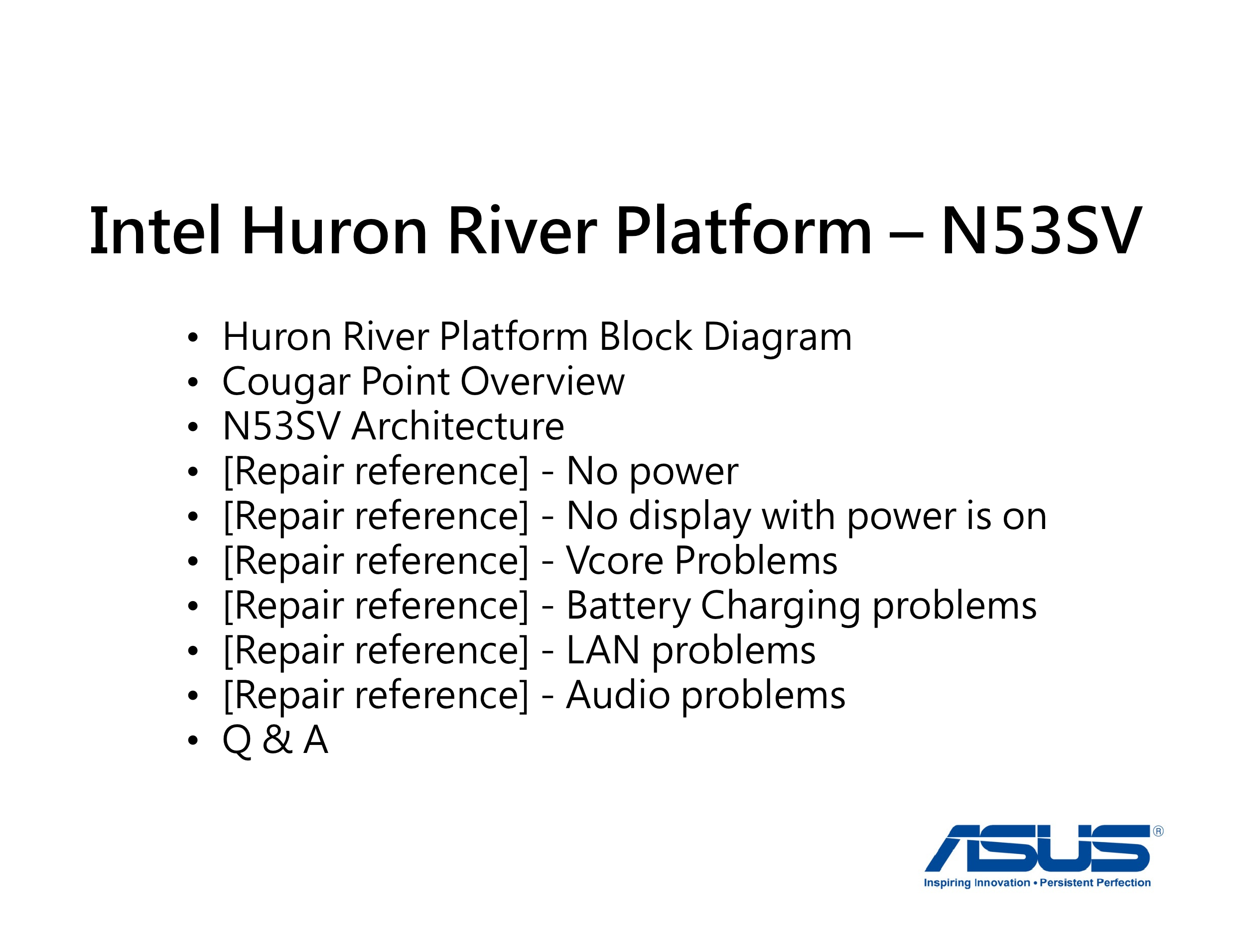

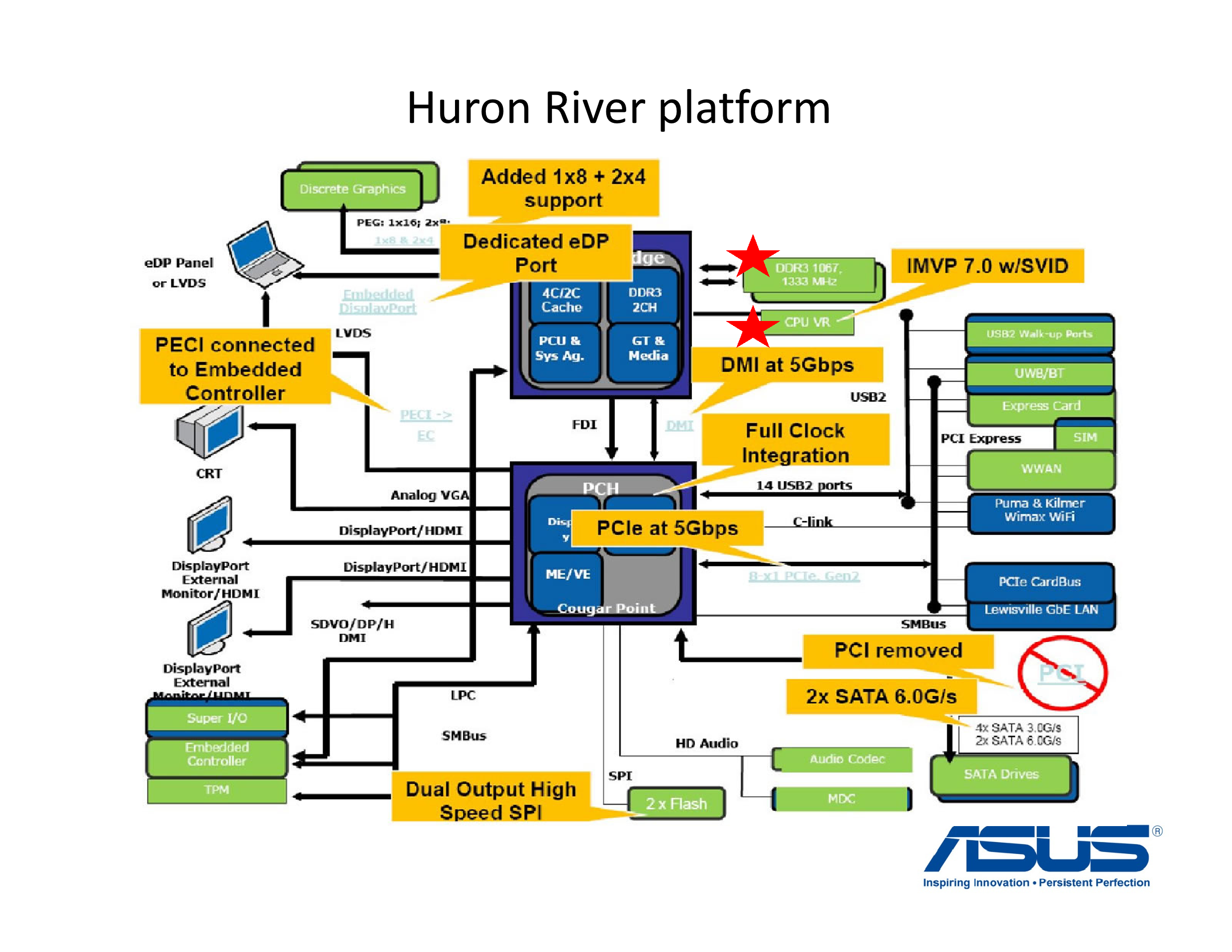

Asus N53SV Sandy Bridge platform
Asus N53SV Sandy Bridge platform 2019-04-07
